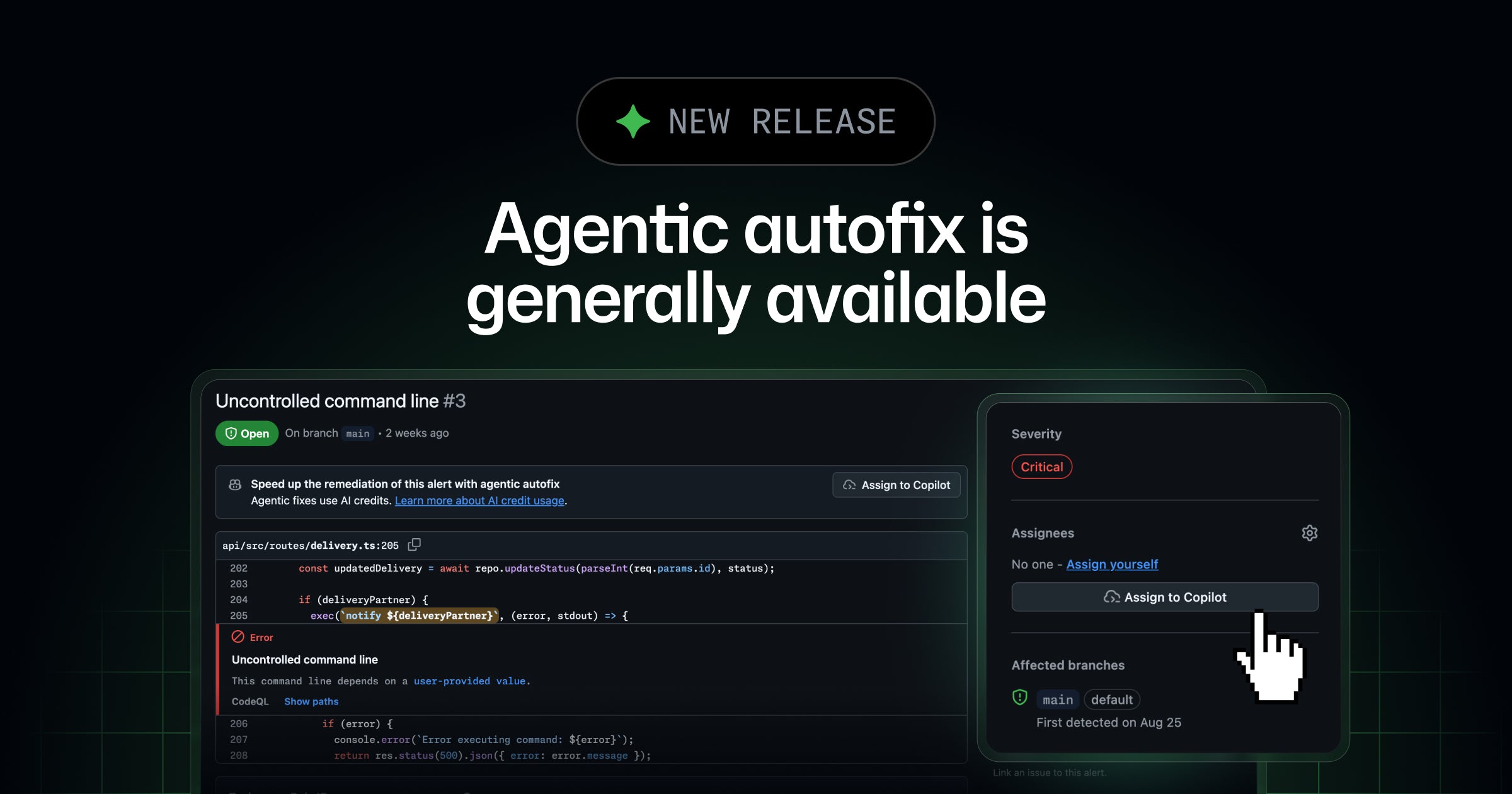

GitHub AI Scan and Agentic Autofix belong at different points in a security workflow. AI Scan adds advisory findings to qualifying pull requests. Agentic Autofix works on eligible default-branch code-scanning alerts to produce a candidate correction and a draft PR. They should not be treated as an automatic detect-to-production pipeline.
For a self-hosted project, use each output as evidence for the next decision. Review a reported issue, review a proposed fix, deploy the supported artifact, and check the running service. A NAS can retain source and recovery files, while the security and deployment work remains with the project’s operators.

Cover: GitHub Agentic Autofix official announcement image. Image source.
