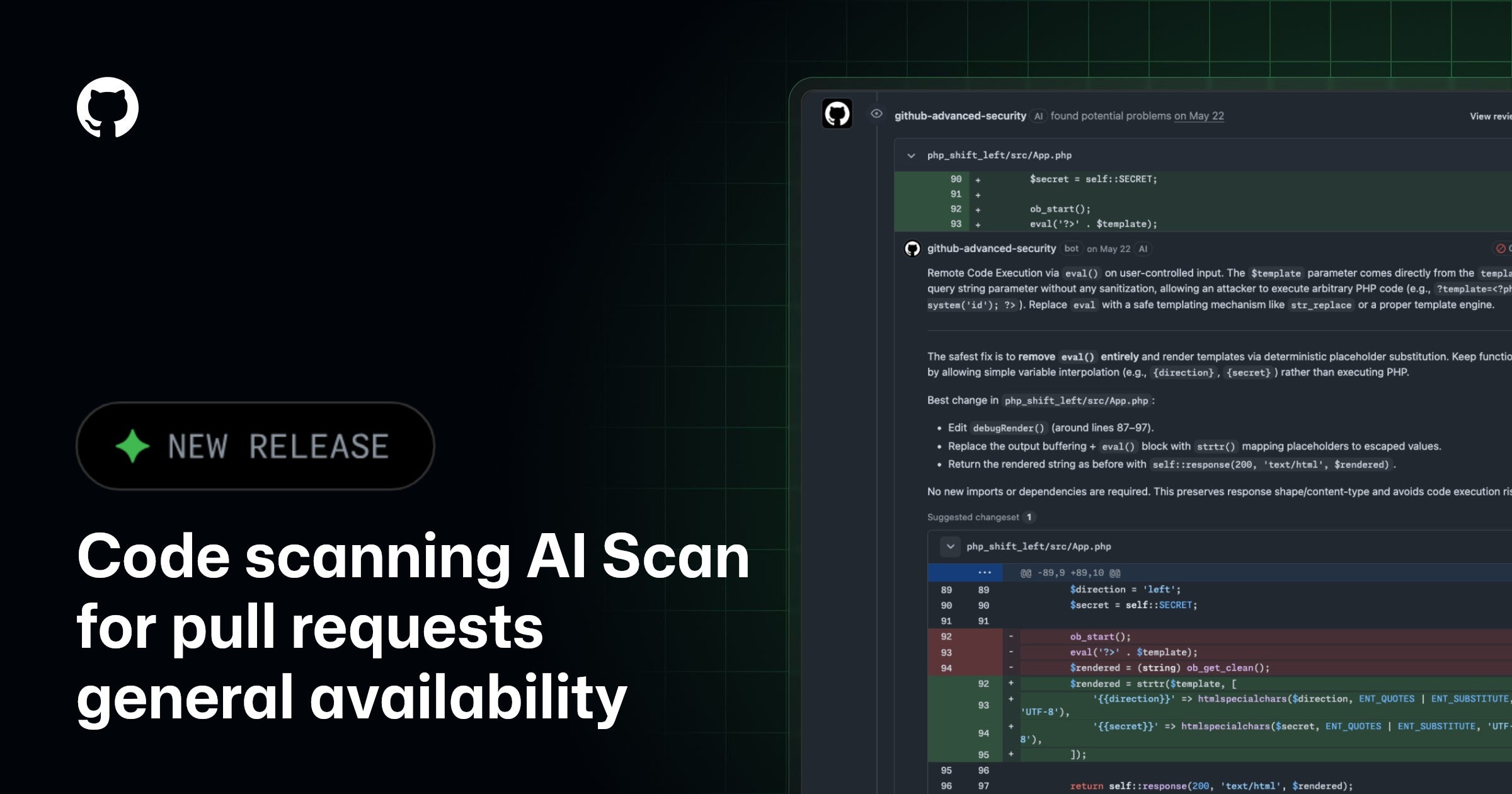

GitHub AI Scan adds security findings to eligible pull requests, including changes in PHP, Shell, and Dockerfiles. It can help review code and configuration around self-hosted apps. Its findings are advisory: they do not fail the code-scanning check or become a merge-blocking ruleset requirement.
Use the feature as another review signal for repositories you maintain. It does not inspect every live service on your NAS, patch an installed PHP runtime, or prove that a third-party container is safe. Keep source review connected to supported updates and verification of the running application.
What does GitHub AI Scan check?
AI Scan complements CodeQL with selected language and framework coverage. GitHub documents PR-based analysis rather than a full repository backlog scan. Findings appear in the pull request with an AI label, making them distinguishable from CodeQL results.
For a home-server project, this can be relevant to a deployment script or Dockerfile you actually change. It is not a replacement for checking the vendor status of the base image and packaged application.
