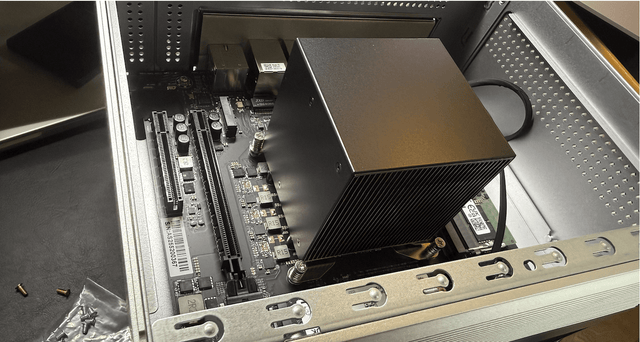

Hardware Compatibility and Boot Requirements
Start with hardware. Confirm CPU architecture, RAM, boot device requirements, drive connections, network adapter support, and whether the machine can boot from the required installation media.
For older hardware, also check cooling, power stability, and whether the device can run for long periods. A machine that works as a desktop is not always reliable as an always-on server.
At minimum, verify:
CPU architecture and OS support.
Minimum RAM and boot device needs.
USB or image-based installation path.
Drive and controller compatibility.
Network adapter support.
BIOS or UEFI settings.
Recovery access if the web dashboard fails.

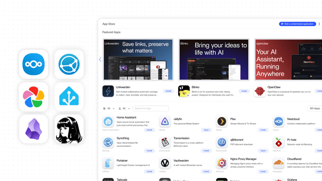

Docker, App Store, or Container Support
If Docker apps are important, check how the OS handles containers before installing.
Some systems focus on app stores or templates. Others expect manual Docker, Docker Compose, containers inside a VM, or services inside LXC environments. The best choice depends on whether you want simplicity, control, or isolation.
Check these details early:
Does the system support Docker directly?
Does it use an app store, templates, Compose, or manual containers?
Where do app volumes and persistent data live?
How are ports published?
Can apps be backed up and moved?
How are permissions handled between the app and storage?
A home server OS that makes apps easy to install can still create problems if data paths and ports are unclear.
