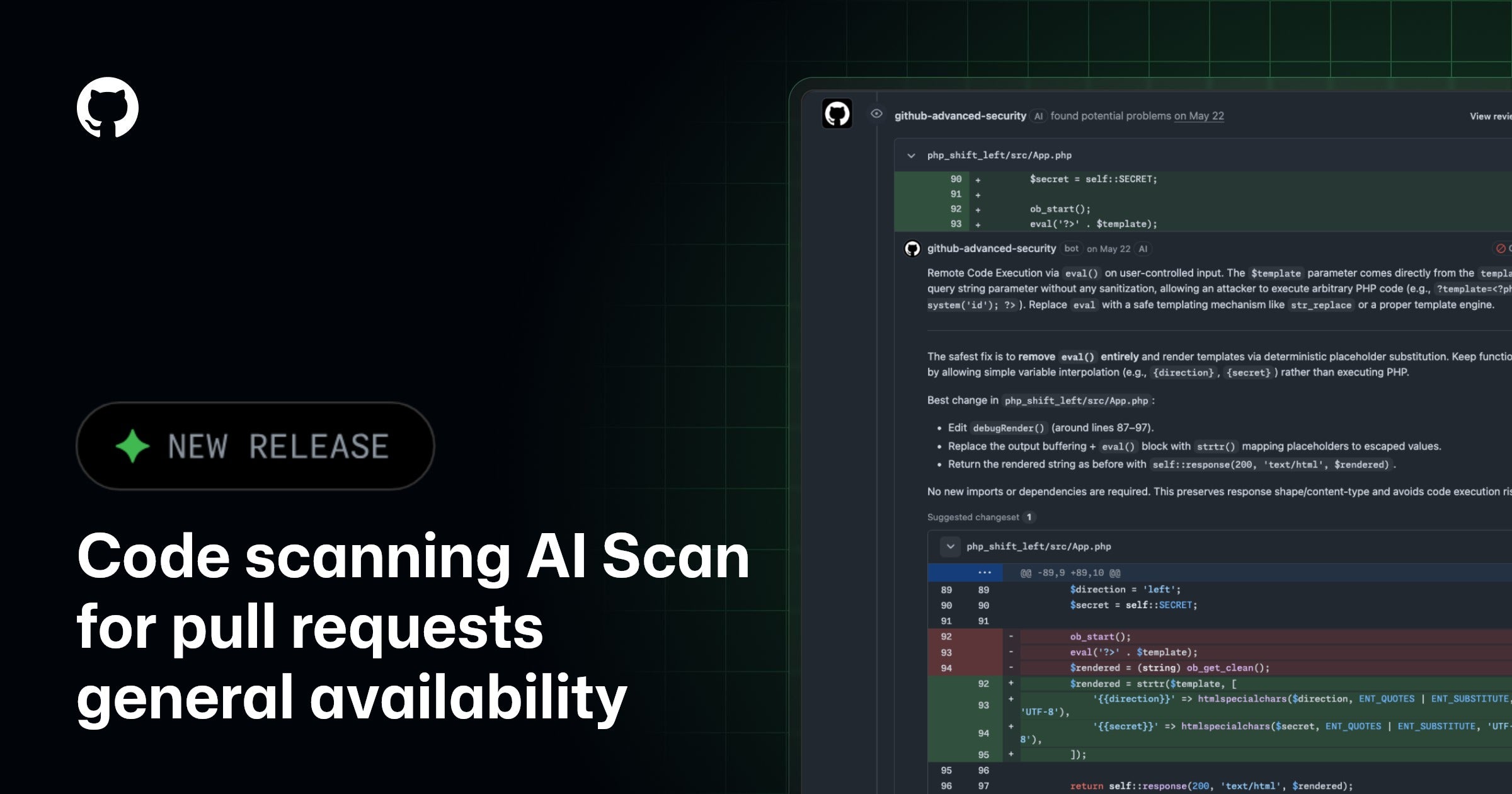

Use GitHub AI Scan to complement CodeQL where its documented language and framework coverage helps your pull-request review. Keep CodeQL for its supported analyses and alert workflows. They are not interchangeable controls: AI Scan findings are PR-only advisory signals and cannot block merges through rulesets.

| Dimension | AI Scan | CodeQL |
| Primary coverage | Selected areas not covered by CodeQL | Supported languages and configured analyses |
| Main finding surface | AI-labeled pull-request findings | Code-scanning alerts and PR results |
| Full-repository backlog | Not supported by AI Scan | Depends on configured analysis |
| Merge control | Advisory; cannot enforce ruleset requirements | Supported code-scanning controls depend on setup |
| Relationship | Complementary signal | Existing analysis and alert workflow |
Check current language support rather than relying on a permanent division. GitHub can expand or change either productโs coverage.
Which helps with PHP, Shell, and Dockerfiles?
GitHub names these among AI Scanโs supported examples. That makes it relevant to repositories combining an app, maintenance scripts, and container configuration. Check the actual changed files and whether the PR qualifies; fork and Dependabot exclusions still apply.
