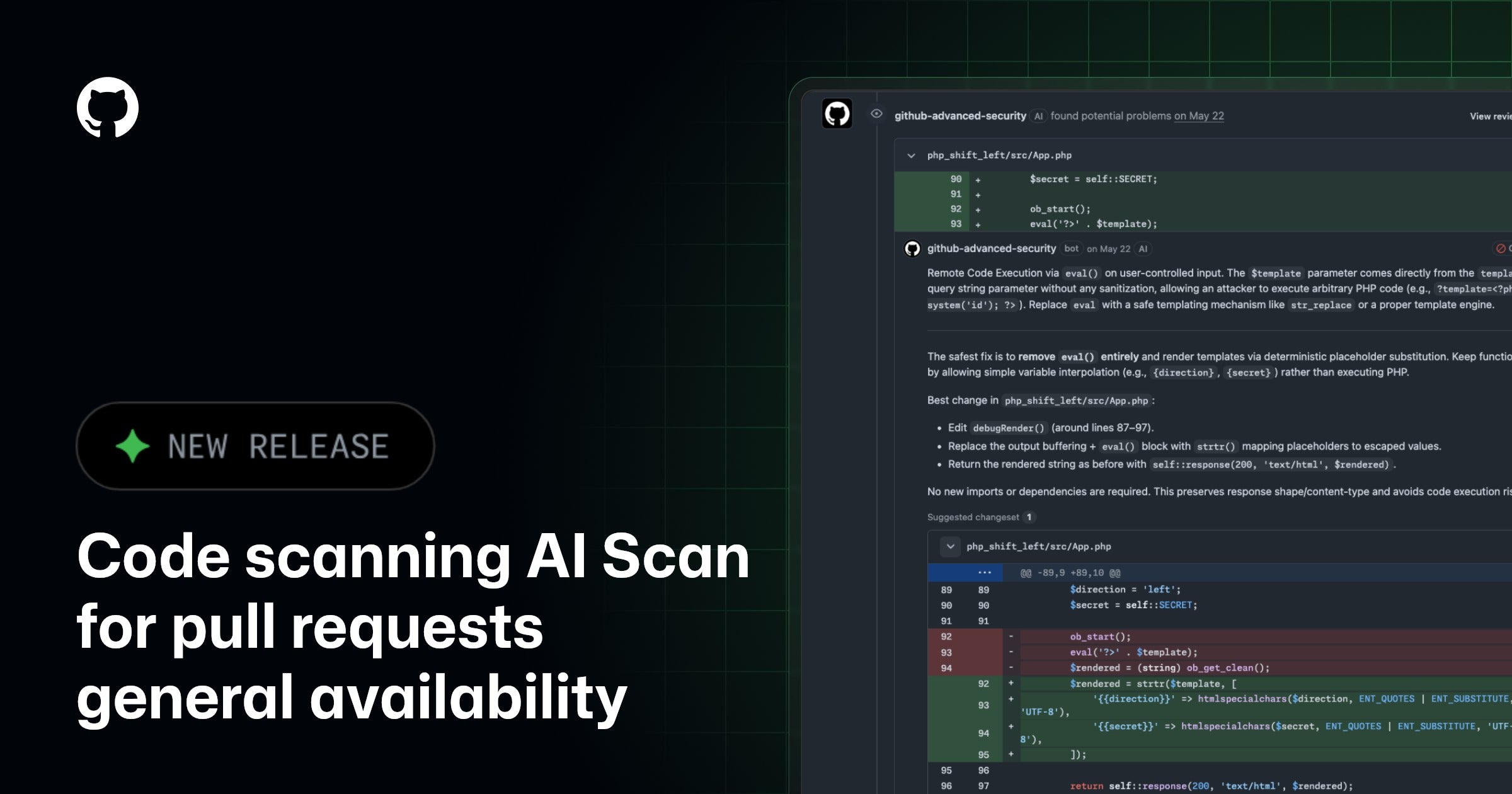

To enable GitHub AI Scan, first check who owns the repository and whether it is eligible. Then confirm code scanning, the effective AI Scan setting, and the billing budget. An organization-owned repository inherits organization controls; a repository administrator cannot override a disabled organization setting just by toggling a local option.
Start with one project you maintain and an ordinary same-repository pull request containing supported changes. Do not seed an exploitable bug to see whether the scanner notices it. Confirm the feature’s effective configuration and review any findings it produces while retaining your normal human review process.

How do I check that a pull request is in scope?
Use a normal PR from the same repository with relevant supported-language changes. Fork and Dependabot pull requests are outside the documented scope. Confirm the effective feature setting and inspect the PR’s Conversation and Files changed views for any AI-labeled findings.
No finding is a possible outcome of an eligible scan. It does not prove either that the engine failed or that the code is secure. The CodeQL comparison explains why the signals differ.
What should happen after a useful finding?
Review the path and proposed fix, apply a scoped correction if warranted, and run the relevant behavior check. Keep required reviews and existing enforceable checks in place because AI Scan findings do not block merges. Deployment still needs the normal supported update and recovery process.
