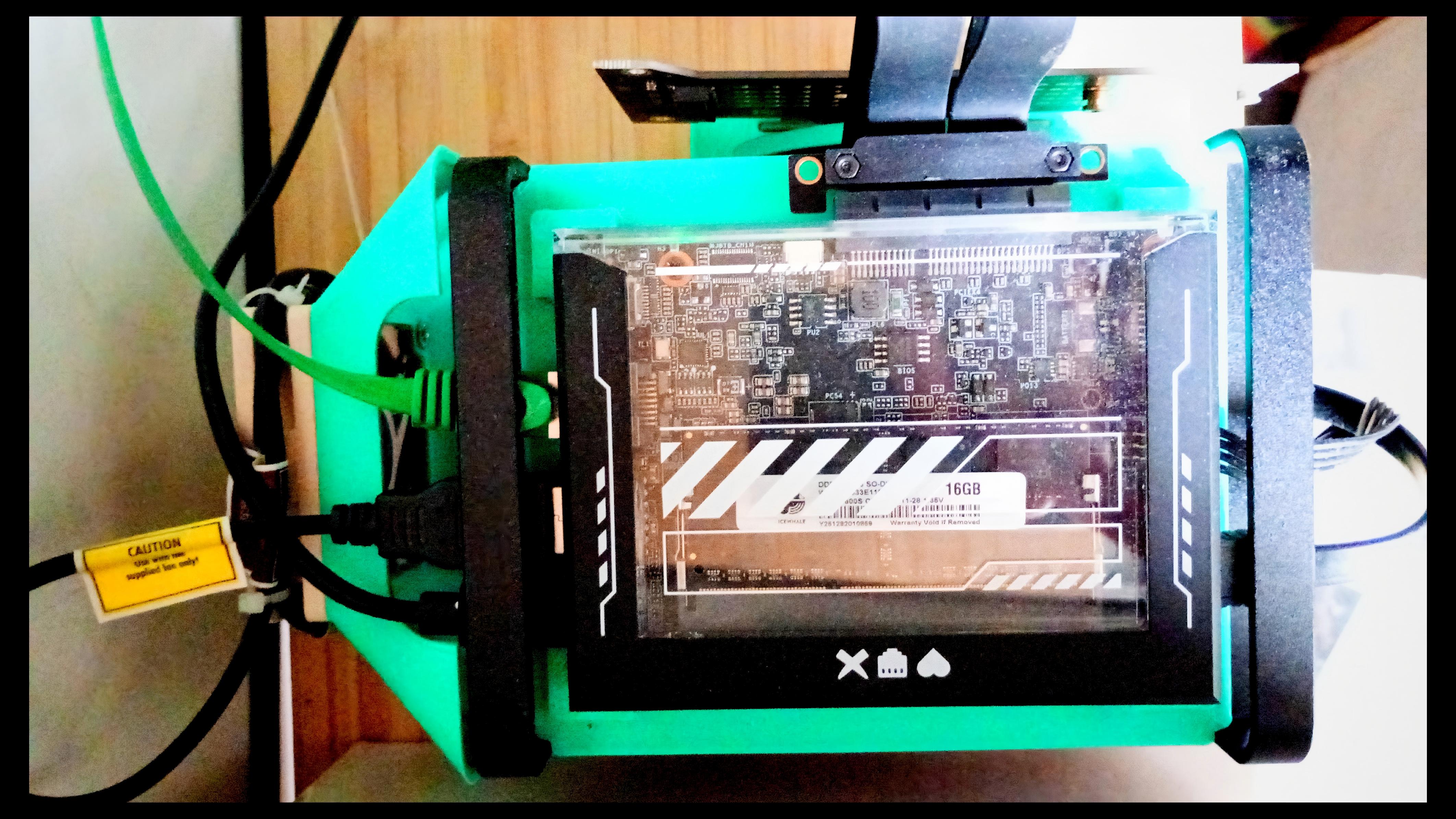

One of Julien’s ZimaBlade systems. Each of the three hosts follows a similar Debian + Docker + ZFS setup.

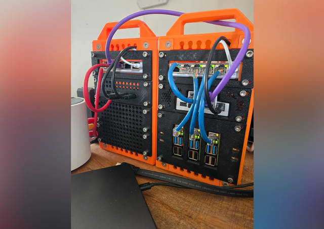

The ZimaBlade kit itself makes assembly very easy. But leaving everything exactly as it came would have been far too reasonable :)) I designed and printed a few additional parts so I could install an 80mm fan and improve airflow underneath the board itself. For me, around 50°C is the limit I try to stay below. So cooling became another little project inside the larger homelab project.
Julien’s custom enclosure and airflow modifications before printing.Julien’s custom enclosure and airflow modifications before printing.
From CAD to hardware: the printed parts installed on the actual ZimaBlade setup.
