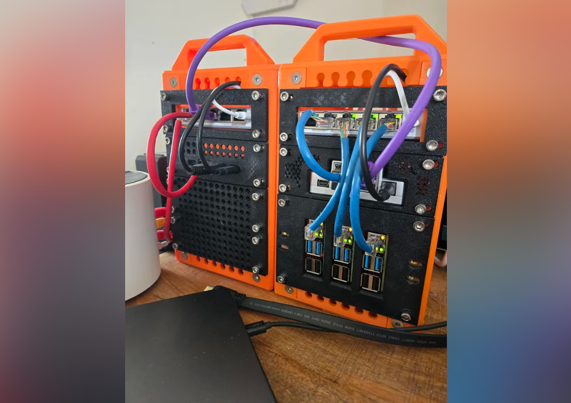

Chris's custom ZimaBlade NAS, built into a 3D-printed carbon-fibre PLA enclosure with a Pi Pico status display.

The enclosure is where things get much more personal. Rather than using a standard case, Chris printed his own in carbon-fibre PLA, with custom faceplates and internal mounting for the HDDs. The design is based on a desktop mini-rack model that he adapted for the build. Chris has also published the models he used on MakerWorld. That means this isn't only a build to look at. Other makers can actually inspect the design and use it as a starting point for their own projects.

The ZimaBoard 2 has a very different job. Chris initially found the Zima boards somewhat overpowered for simply acting as NAS boxes. Each of his ZimaBoard 2 systems has 16GB of RAM, which opened up more interesting possibilities. So instead of giving them another storage job, he started experimenting with local models. And then brought the Raspberry Pis into it. His current experimental cluster includes:
  • ZimaBoard 2
  • Raspberry Pi 5
  • 3 × Raspberry Pi 4
  • k3s
  • Ollama
The interesting part is not simply putting several machines into a cluster. They're running different architectures. ZimaBoard 2 provides an x86 node. The Raspberry Pis provide ARM nodes. Chris uses k3s to distribute workloads between them while experimenting with appropriately sized Ollama models for the capabilities of each machine. A larger machine gets one workload. A smaller Pi gets something more suitable. At least, that's the theory.
