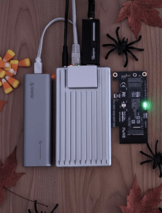

Passive cooling removes the fan as a failure point, but it does not remove thermal limits. ZimaSpace supplied compact-server benchmark recorded about 80°C CPU package temperature and a 55°C case surface during sustained passive load, with no observed throttling in that test. Adding a PWM fan reduced the reported figures to about 64°C and 36°C respectively, showing that optional airflow can create useful headroom.
Those results are device-specific. They do not prove that every fanless system will maintain its frequency in a hot cabinet or under a different service mix. Leave ventilation around a passive chassis, avoid enclosed furniture, and test the workload that will actually run overnight.
