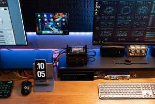

A compact platform such as the ZimaBoard 2 can be a fit for a small personal server or DIY NAS because it uses an Intel N150 platform with a stated 10W processor TDP, dual 2.5GbE, SATA, PCIe, and USB expansion. That 10W figure is not the annual NAS power draw: drives, memory, attached devices, conversion losses, and workload must still be measured at the wall.
