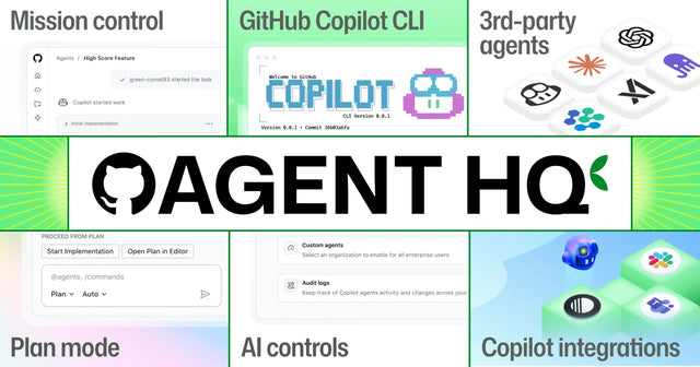

GitHub Universe 2026: What AI Coding Agents Need Beyond Better Models
GitHub Universe 2026 highlights the next challenges for AI coding agents: memory, permissions, code verification, software supply-chain security, and the infrastructure needed for reliable...
