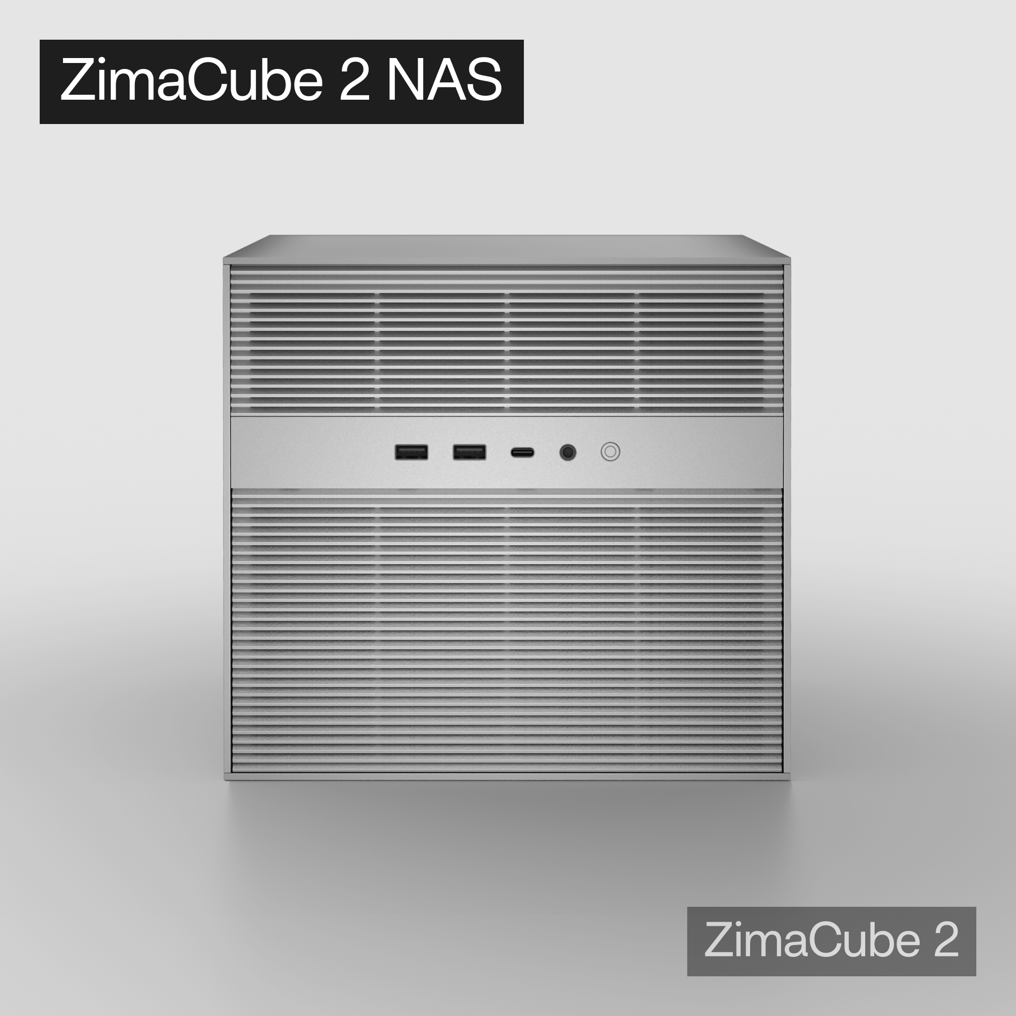

What role can ZimaCube 2 play in this setup?
It can preserve project inputs, accepted outputs, and configuration records, or host compatible services that fit its configuration. Confirm software requirements before choosing the execution host. Do not infer that the complete Flash-1017 model runs on the NAS because the harness accesses an API.
Keep the source archive separate from disposable test workspaces. Our limited NAS working-set pattern helps maintain that separation when the workflow becomes recurring.

Explore ZimaCube 2 Personal Cloud Home NAS for private storage and compatible self-hosted services. Model-serving requirements and remote data processing should be assessed for the chosen workflow.
