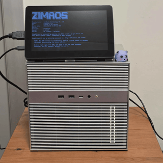

A system such as the ZimaCube 2 Personal Cloud NAS can provide a flexible base when the plan includes storage-heavy services, containers, virtualized workloads, and later expansion. The platform choice should still follow the workloads rather than the maximum number of features the hardware can expose.
