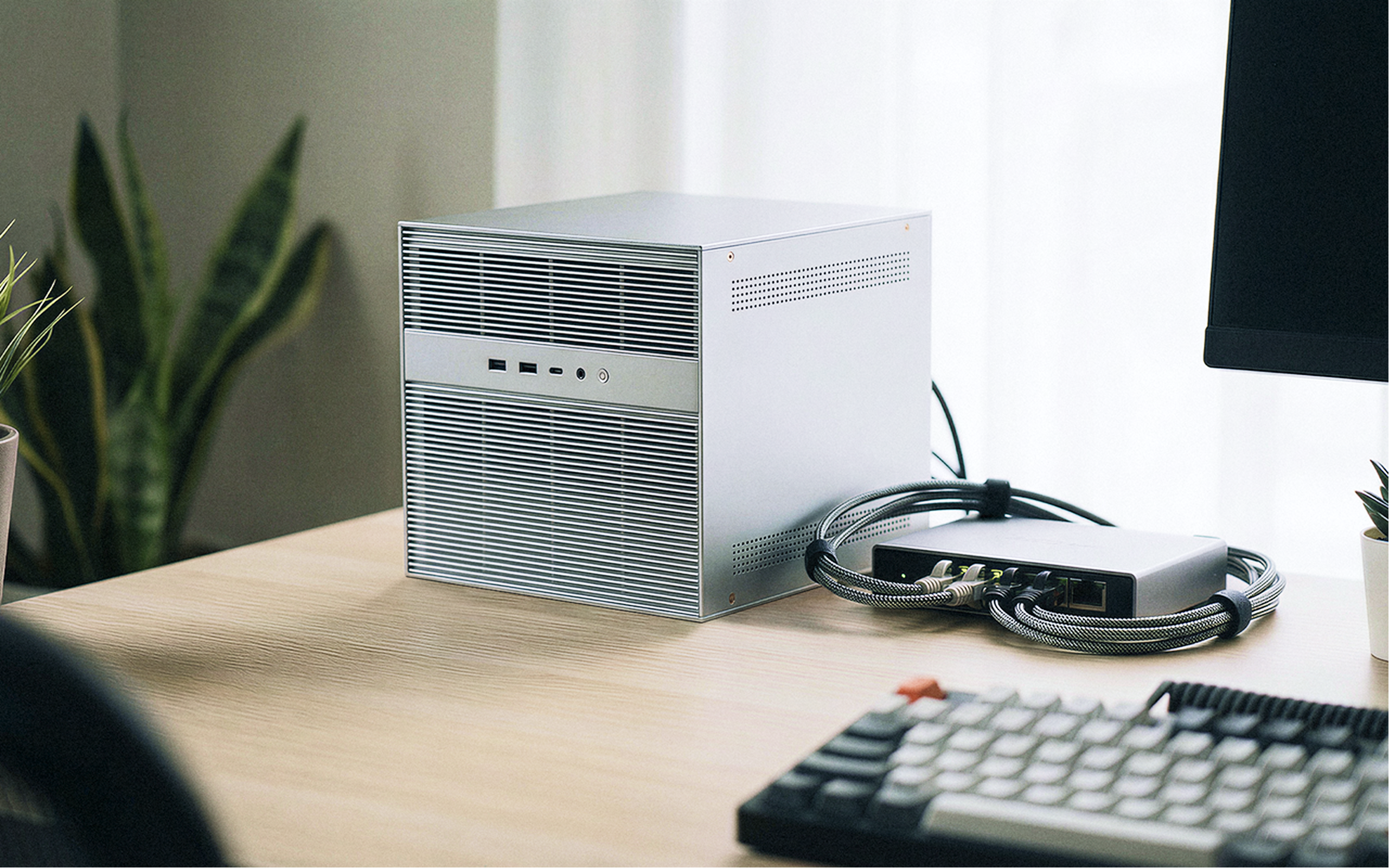

Where a Home Document Server Fits Private RAG
For home documents, the useful product pattern is not a giant-model workstation. It is a local-first document server that stores the archive, runs private search, manages self-hosted apps, and gives the local model the right document context when needed.
ZimaCube 2 Standard / Pro fit this private RAG side of the decision as personal cloud and self-hosting options for users who want home documents, indexes, and local AI workflows to stay under their own control. The product page lists Standard as i3-1215U / 8GB / 256GB and Pro as i5-1235U / 16GB / 256GB, while the Creator Pack is the separate RTX Pro 2000 configuration.
The fit is strongest when you need storage, local access, self-hosted apps, containers, and enough headroom for a private document workflow. ZimaCube 2 is positioned around personal cloud, media workflows, self-hosting, expansion, 6+4 hybrid storage, NVMe tiering, one-click apps, and container deployment, but Standard / Pro should not be framed as enterprise-grade full local LLM workstations.
