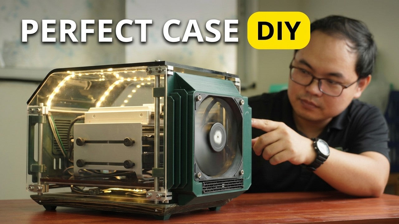

Thank you to The TKT Works for sharing a custom ZimaBoard 2 case made with a rod frame, clear acrylic, a small display, and revised cooling. The build follows the mechanical work from alignment problems to the final assembly. You can watch the original YouTube video on the creator’s channel.
Watch before reading: This video is useful if you want to enclose a mini server while keeping the hardware visible and accessible. In about 13 minutes, The TKT Works explains why the open board needs a case, then shows the materials, spacing aids, display, cable routing, and top cover.
The main lesson is that adding a case changes the whole assembly. Protection, alignment, cable clearance, and airflow have to work together. The video is a fabrication walkthrough, rather than a NAS software tutorial or a measured comparison of cooling performance.

The creator starts with the distinctive metal body of ZimaBoard 2 and a storage kit that can become a small NAS. The goal is to add protection around the assembly without concealing the board’s appearance. Clear panels preserve that view, while a separate frame provides positions for mounting the surrounding parts.
That is a useful starting distinction for a custom case: the panels, frame, drives, and board each impose different requirements. Work from the assembled hardware, including its connectors and attached cables, rather than treating the published board dimensions as the entire space requirement. Check access to the fasteners and connections that you will need during maintenance.

To tidy the front view, The TKT Works rotates the hard drive, changes the cable arrangement, and routes the connections underneath. These choices show how drive orientation affects the rest of the build. A clean front is the visible result; sufficient cable length, connector clearance, and access from below are the practical conditions that make it possible.
If your own version uses different cables, check the route with the drive installed and the panels in place. Avoid tension at the plugs, leave enough movement for maintenance, and keep wiring clear of the fan. If you add a second drive later, revisit the space and power arrangement before assuming that the original routing still works.
Revisit cooling when an open board becomes enclosed
The creator replaces the original fan arrangement with a larger fan because the hardware now sits inside a box. A one-piece bent acrylic top completes the enclosure and gives its otherwise straight-edged frame a softer outline. Both changes belong to the same final check: the finished shell must allow heat to leave while holding the hardware securely.
Before relying on a similar case, compare behavior with the panels open and closed during the same sustained workload. Watch the board and drive temperatures, check that the fans have an unobstructed air path, and confirm that the enclosure remains accessible. The Noctua fan catalog can help compare candidate sizes and specifications, but a larger fan by itself does not establish a measured improvement in a particular case.
