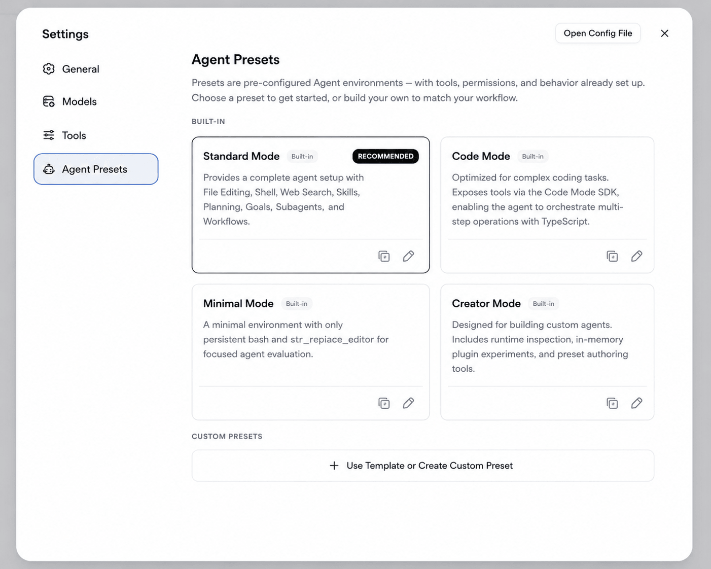

| DeepSeek Harness Mode | Core Purpose | Best For | Main Difference |
| Standard | Full everyday agent execution | Coding, research, repository work, multi-step tasks | Full tool and agent environment |
| Code | Programmatic tool orchestration | Repeated, conditional, or multi-step tool workflows | Tools are composed through generated TypeScript |
| Minimal | Reduce harness assistance | Benchmarks and model evaluation | Only persistent bash and a file editor |
| Creator | Build or modify agent presets | Plugin experiments and custom harnesses | Adds runtime inspection and preset authoring |
1. Standard Mode — The Default Full DeepSeek Agent Environment
Standard Mode is the natural starting point when your goal is simply to give DeepSeek a job and have it complete that job. It includes the full coding-agent environment: file editing, shell access, file and web search, skills, planning, goals, subagents, and workflows. Instead of requiring you to manually decide every next step, the model can inspect the environment, act, observe the result, and continue.
That creates the familiar agent loop: inspect a repository, search for relevant files, read code, make an edit, run a command, inspect an error, and revise the result. The important capability is not any single tool in that list. It is the ability to keep moving through the environment as new information appears. DeepSeek's plugin architecture makes those capabilities composable rather than treating the agent as one fixed application; coverage of the release has described it as a plugin-composable agent runtime.
For most users, that makes Standard Mode the correct default. If you want DeepSeek to investigate a bug, understand a repository, implement a feature, inspect several files, or coordinate a normal multi-step coding task, there is little reason to deliberately remove tools before you know that they are causing a problem.
Standard Mode becomes less suitable when the purpose of the session is evaluation rather than productivity. If a model succeeds because search, planning, skills, subagents, and other harness components compensate for its weaknesses, the final result tells you how well the agent system performed. It does not cleanly tell you how well the base model would perform with minimal external assistance.
2. Code Mode — Let DeepSeek Turn Tool Orchestration Into a Program
Code Mode is the easiest of the four modes to misunderstand. It does not mean “Standard Mode, but only for coding tasks.” According to DeepSeek's current definition, Code Mode retains all Standard Mode capabilities. The change is how the tools are exposed to the model: DeepSeek can use the Code Mode SDK to combine multiple operations inside a model-generated TypeScript program.
In a normal agent loop, a complex task may require repeated exchanges between the model and individual tools. The agent searches, receives a result, decides what to read, reads it, processes that result, calls another tool, and continues. The Code Mode SDK moves some of that control flow into executable code, allowing the model to express loops, filtering, branching, and several dependent tool operations as a program instead of a long sequence of isolated tool calls.

3. Minimal Mode — Remove the Harness and See More of the Model
Minimal Mode is not a lightweight option intended for slower PCs or smaller home servers. It is a deliberately constrained agent environment. DeepSeek currently defines it as a two-tool coding agent with persistent bash and str_replace_editor, removing the wider search, skill, subagent, and workflow surface available in Standard Mode.
The reason for that restriction is evaluation. DeepSeek itself used DeepSeek Harness Minimal Mode for public Code Agent benchmarks reported with V4-Flash. That usage makes the intent much clearer: Minimal is designed to reduce surrounding agent machinery when researchers want a narrower view of what the model can accomplish with a small, controlled set of tools.

4. Creator Mode — Use DeepSeek Harness to Change the Harness
Creator Mode changes the object you are working on. Standard Mode primarily uses an agent environment; Creator Mode is designed for creating and experimenting with that environment. It includes the capabilities of Standard Mode while adding runtime inspection, in-memory plugin experimentation, and guidance for authoring custom presets.
This follows directly from the architecture underneath DSH. DeepSeek describes models, tools, skills, sessions, sandboxes, storage, loops, scheduling, and even the UI as plugins that can be selected, replaced, or recomposed. The Cordis kernel manages plugin mounting, unmounting, and dependencies, which means extending DSH does not necessarily require modifying a privileged monolithic agent core. The broader design is why the project's “everything is a plugin” claim matters more than the existence of four presets by itself.
