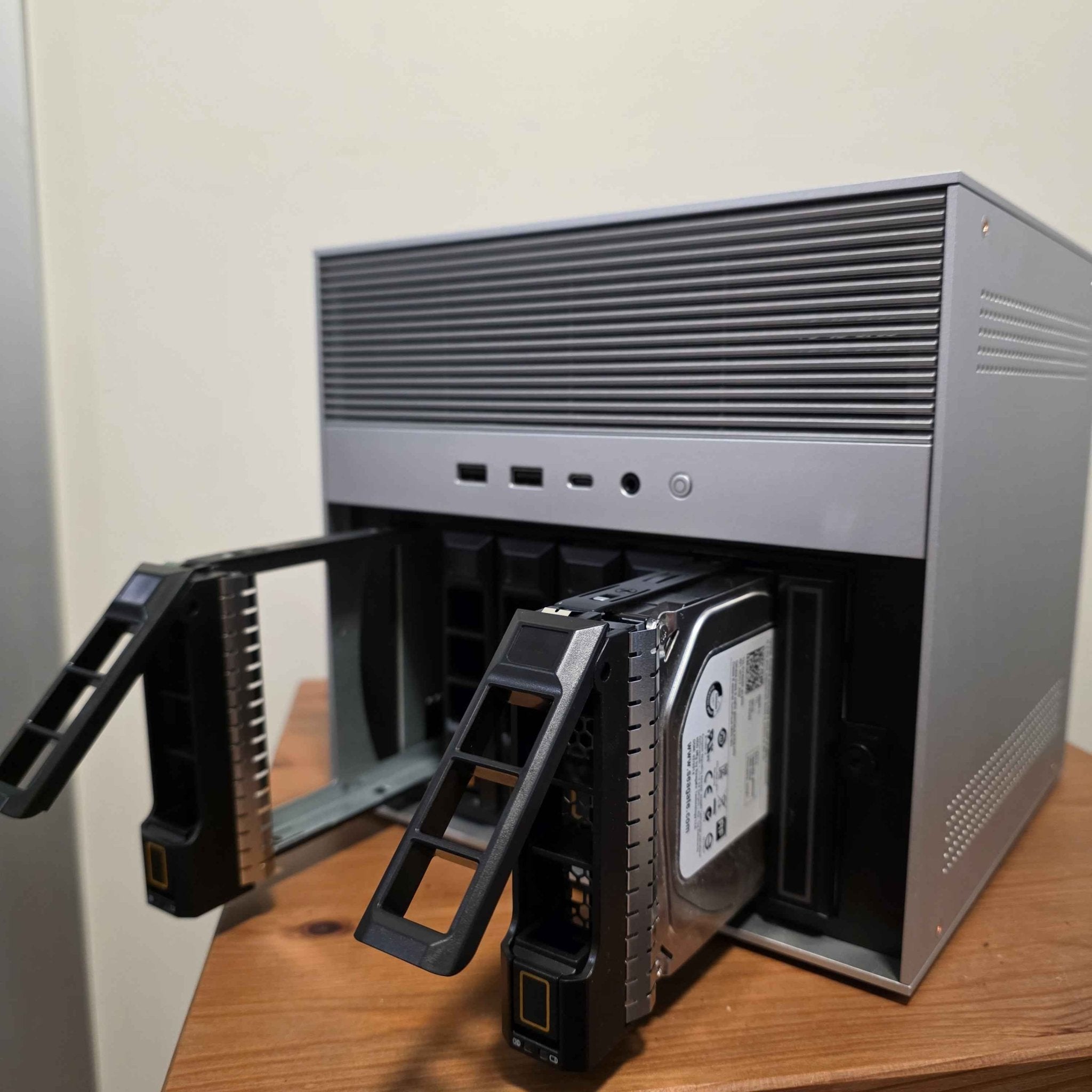

For buyers who want one system to handle both planes, the ZimaCube 2 NAS is a relevant hybrid-storage example because it can combine multi-drive capacity with faster storage for active workloads. The product fit still depends on the required usable capacity, redundancy, network, application workload, and backup plan.
