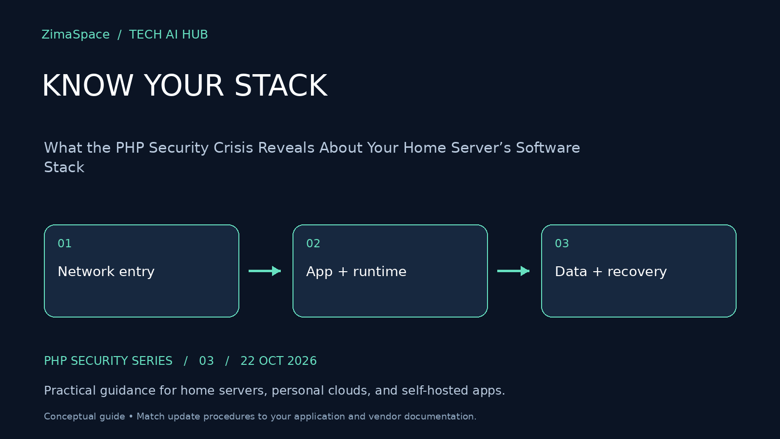

A home server can look like a short list of apps while containing several independently maintained software layers. The October 2026 PHP emergency makes that distinction practical: the application version shown in a dashboard may not tell you which PHP runtime handles web traffic.
Start by identifying the runtime inside each application or container, then match it to the vendor advisory and supported update. Check the actual process serving requests; the PHP version installed on the host can differ from the one used by the exposed application.
Follow one request through the system
Consider a browser reaching a self-hosted file application. The request may pass through a router, tunnel, or reverse proxy, reach a web server, and then execute PHP in a separate worker or container. The application may query a database and read or write mounted folders.
Each boundary answers a different question. Routing determines who can connect. The runtime determines which executable processes the request. Storage permissions determine what that executable can access. Backups determine whether you can recover from loss or an unwanted change.
Create a compact dependency record
| Layer | Record | Evidence to keep |
| Public entry | Domain, proxy, tunnel, IPv4 and IPv6 paths | Access rules and tested routes |
| Application | Release and supported upgrade path | Maintainer release notes |
| Runtime | PHP branch, package source or image digest | Vendor advisory and local version check |
| Persistent state | Database and writable mounts | Backup and restore instructions |
| Operations | Owner and maintenance window | Last verified update |
Keep the record small enough to update whenever you install an app. A perfect diagram that nobody maintains is less useful than a short current table.
Why can an updated host still serve vulnerable application code?
Consider a request arriving at a reverse proxy, passing to an application container, and reaching PHP-FPM inside that image. The hostโs package manager, the proxy image, and the PHP application image are separate update units. Updating the first two does not necessarily replace the third. A scheduled worker may also use a different container from the web front end.
Build the map around execution rather than branding: which process receives the request, where its executable comes from, and which persistent state it can modify. Dockerโs volume lifecycle documentation explains why persistent data can outlive a container. That persistence is valuable, but it also means an image replacement and a data recovery plan are different jobs.
Why updates can miss a layer
A host package update may leave an application image unchanged. Pulling a new image may leave an existing container running. Replacing the web service may leave a separate queue worker on its previous image. A command-line PHP binary may differ from the web-facing PHP-FPM service.
Use the dependency record to choose the update unit. In a maintained appliance package, that may be the vendor package. In a custom Compose deployment, it may be several service images. Verify each relevant executable instead of declaring the whole device patched after one command.
