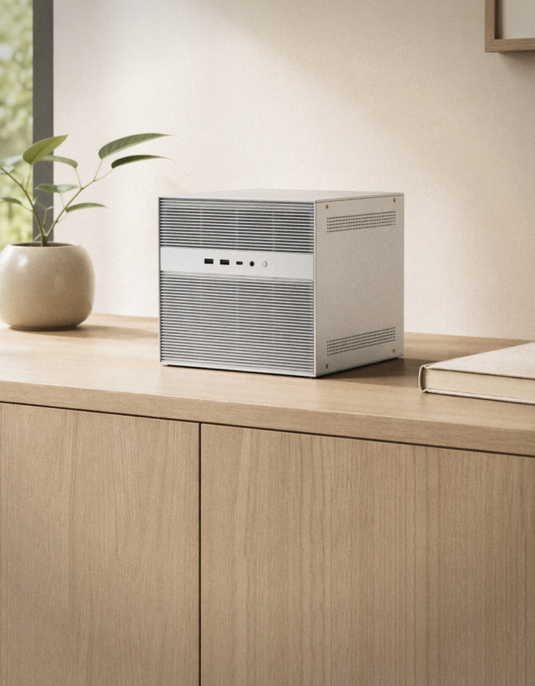

ZimaCube’s hardware configuration gives it a natural advantage as a backup hub: six drive bays for a storage pool, NVMe storage as a fast backup target, and dual 2.5GbE ports for data transfer. This guide walks you through building a three-layer backup chain: VMs → PBS → local storage → cloud.
This guide assumes that you are already running Proxmox VE on ZimaCube. If you are still using ZimaOS, the backup strategy will be different. You can use ZimaOS’s built-in snapshot and remote sync features instead.
