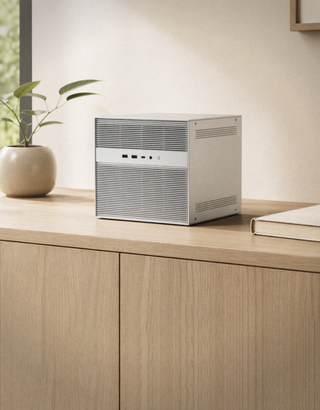

ZimaCube + Proxmox Setup Guide: Turn It Into an All-in-One Virtualization Server
With its solid hardware foundationโ€”6-core x86 processor, 64GB DDR5 memory, six drive bays plus four NVMe slots, and dual PCIe slotsโ€”ZimaCube is clearly built for more than just NAS duties. Once Proxmox VE is installed, it can become a true home server: running virtual machines, managing containers, enabling GPU passthrough, and even handling your whole-home network.
This guide walks you through the process of turning ZimaCube into a Proxmox virtualization host from scratch.
Who this guide is for: This guide is best suited for users who have already spent some time with ZimaOS or TrueNAS and want to explore virtualization, software routers, and Windows/Linux virtual machines. If you are new to NAS, we recommend starting with ZimaOS first.
