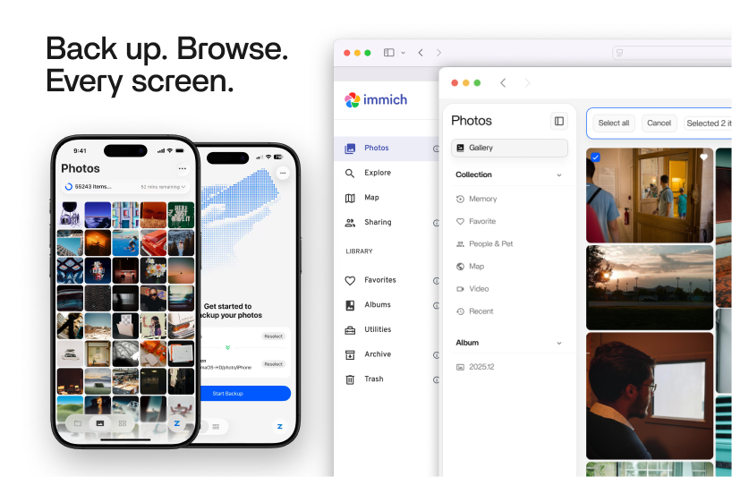

Find App State Outside the Visible Shared Folder
Self-hosted apps often separate user files from application state. A photo folder can hold originals while the database, thumbnails, face data, secrets, and configuration live in other locations.
Container deployments use persistent Docker volumes and bind mounts to store state independently from the image. Backing up only the media share can therefore preserve visible files while omitting the state required to rebuild the app.
Inventory the complete recovery unit: Compose file, environment variables, secrets, named volumes, bind mounts, database dump, application configuration, and user-data paths. Add the real sources or an application-aware export instead of assuming one share contains everything.
