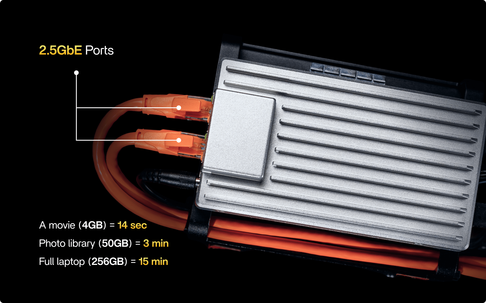

The link falls back because 2.5GbE is not available across the complete physical path.
On a home NAS, the port label proves only one endpoint capability. The client NIC, switch port, adapter, cable pairs, wall termination, driver, and advertised settings must all support a stable 2.5GbE mode. The fastest diagnosis is to confirm the negotiated rate, identify the weakest link partner, and replace one path element at a time.
