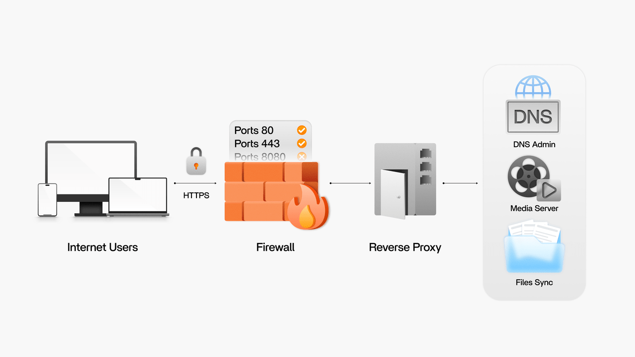

Remove the Test Rule When It Does Not Need to Stay Public
Once the failing layer is identified, apply the smallest correction and repeat the same outside-in test. Do not open a range of ports or disable the entire firewall simply to see whether something changes.
The ZimaSpace guide to checking home-server exposure provides the next security check after a forwarding rule begins working.
Keep a public rule only when the service is intentionally internet-facing, authenticated, patched, logged, and isolated from management interfaces. For private dashboards, SSH, SMB, and personal files, a VPN or authenticated tunnel is usually a clearer boundary than a permanent forwarded port.
