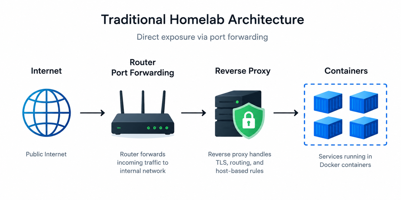

Recreate Manual Port Forwards and Local Firewall Rules
Confirm the service is listening locally, then recreate the exact external port, internal address, internal port, and TCP or UDP protocol. Test one service at a time from mobile data.
Plex remote-access troubleshooting notes that manual forwarding is often more stable than relying on UPnP mappings that a router may shift or recreate differently. The useful control is a fixed manual port forward to a reserved server address.
Check the router firewall and the server firewall separately. A forwarded packet still fails if the new router blocks WAN input, the server trusts only the old subnet, or the application listens on a different interface.
