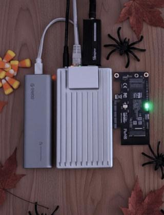

Adding storage to a home server usually starts with a simple question: should you use an internal PCIe expansion card or connect an external USB enclosure? The better choice depends less on the connector name and more on what the storage will do every day.
USB is convenient for a removable disk, a backup target, or a quick capacity increase. PCIe expansion takes more planning, but it can provide a more direct path for host bus adapters, NVMe devices, and multi-drive storage systems.
For beginners, the practical decision is whether the new storage is a temporary accessory or part of the server’s long-term data path. That distinction affects monitoring, recovery, upgrades, and the amount of troubleshooting you may need later.
What PCIe and USB Actually Change
PCIe expansion cards connect through the server’s internal bus and are commonly used for SATA, SAS, NVMe, or network controllers. A host bus adapter can expose individual drives to the operating system, which is useful when software such as ZFS needs to inspect disks and manage redundancy itself.
USB storage passes through a host controller, cable, enclosure bridge, and sometimes a hub. The Intel xHCI design documents bandwidth domains and port-level resource management, so the practical result can depend on which devices share a controller and how the enclosure negotiates with the host.
This does not make USB unusable. It means that a USB label such as “10Gbps” describes the interface ceiling, not a guaranteed storage result under every topology. Cable quality, bridge firmware, UAS support, power delivery, and concurrent devices still matter.
