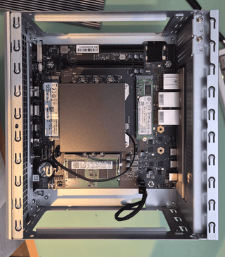

4. Memory and PCIe Slots Within Easy Reach: No Real “Disassembly” Required
Here is the full process for replacing memory or adding a PCIe card on the ZimaCube:
Remove the front panel, which is magnetic and takes about 3 seconds. Slide off the side panel, which takes another 5 seconds. The memory and PCIe slots are right in front of you.
There is no need to remove the drive cage, unplug cables, or move any other components.
On many compact NAS systems, replacing memory requires removing the drive cage or even the power module first. The ZimaCube’s internal layout is clearly intentional: the components users are most likely to upgrade are placed exactly where they are easiest to access.
5. Internal USB 2.0 Header: Quietly Waiting to Be Discovered
There is a standard 9-pin internal USB 2.0 header on the motherboard, the same kind used for front-panel USB ports in desktop PCs.
This is an interface that does not need to exist. Without it, the ZimaCube would still be the ZimaCube. But once it is there, many new possibilities appear:
- Install a tiny internal USB drive as an Unraid boot drive
- Keep a recovery USB drive connected permanently
- Connect a Zigbee or Z-Wave dongle, which Home Assistant users will appreciate
- Add a Bluetooth adapter without occupying an external USB port
Finding room for an internal USB header on a compact NAS motherboard suggests that the PCB layout was not just about fitting the essentials. It was also about asking, “What else could we add?”

Mystery 1: Four Mysterious Standoffs
On one side of the chassis, there are four evenly spaced standoffs. They are clearly placed there intentionally: the spacing is regular, the position is symmetrical, and they do not interfere with other internal structures.
But at the moment, they do not correspond to any installed component. There is no bracket, no cover plate, and no official documentation explaining them.
