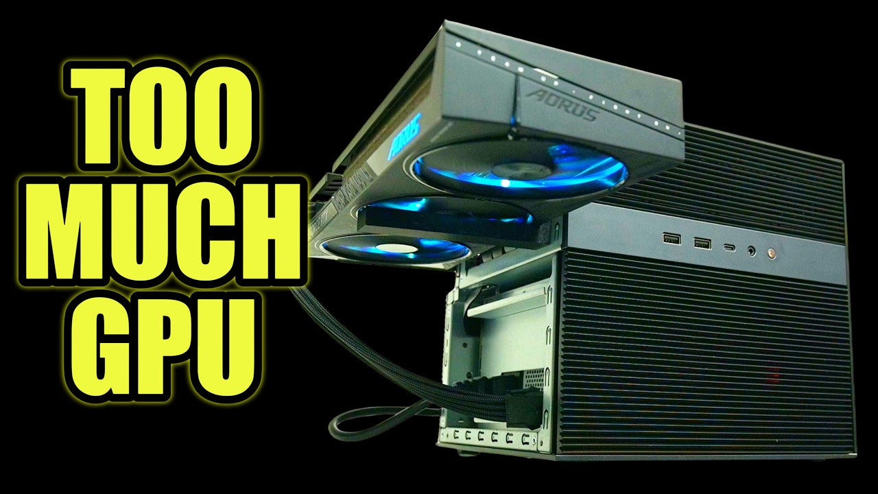

Mounting an RTX 5060 Outside the Chassis
The next step removes the graphics bottleneck much more aggressively. TrashBench connects an NVIDIA GeForce RTX 5060 through a PCIe riser cable. The card cannot fit inside the NAS, so it must sit beside the chassis.
Rather than leave the GPU hanging from the cable, he designs and prints a frame that supports it against the side of the ZimaCube 2. A cable tie secures the assembly where it remains hidden from normal viewing angles. The result is unconventional, but it protects the PCIe connection and keeps the graphics card in a repeatable position for testing.
The RTX 5060 brings a very different level of graphics capability. NVIDIA lists the desktop card with 3,840 CUDA cores and 8GB of GDDR7 memory in its RTX 5060 family specifications. The NAS processor now has enough GPU performance available that the experiment can shift from “Will the game run?” to “How much can the CPU feed the card?”

How Much Faster Did the RTX 5060 Make It?
The RTX 5060 changes all three benchmark results. Hitman 3 rises from approximately 18 FPS on the integrated GPU to 167 FPS, an improvement of about 828%. Cyberpunk 2077 increases from roughly 13 FPS to 90 FPS, while Shadow of the Tomb Raider moves from about 31 FPS to 124 FPS.

Why a Faster GPU Did Not Keep Improving Performance
TrashBench also tries an RTX 4080 Super, expecting a higher-end card to push the results further. Instead, the system becomes so CPU-limited that the much larger GPU performs similarly to—or sometimes worse than—the RTX 5060.
This is the central lesson of the build. A game frame passes through multiple stages. The CPU handles simulation, draw-call preparation, background work, and other logic before the GPU renders the scene. When the graphics card finishes faster than the processor can prepare new work, additional GPU capacity sits unused.
The system even reaches the top position in the video creator's comparable 3DMark Time Spy records for the Core i5-1235U, ahead of runs paired with RTX 4080 and RTX 3090 cards. That does not mean the NAS processor is faster than a desktop gaming CPU. It means the RTX 5060 is already beyond the useful graphics threshold for this particular processor and workload.
