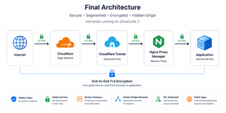

Reverse Tunnels Help When You Need an External URL Without Opening Ports
A reverse tunnel is useful when you cannot or do not want to open inbound ports on your router. This is common with CGNAT, locked-down ISP routers, apartment internet, or users who prefer not to expose the home router directly.
Cloudflare Tunnel uses an outbound tunnel for remote access, where the connector inside your network initiates the connection outward. Mobile devices then access a public hostname that routes back through the tunnel.
This can make mobile data access easier, but it should still be configured carefully. Use access policies, HTTPS, narrow service exposure, and separate admin interfaces from public user-facing services. A tunnel solves reachability; it does not automatically solve permissions or app configuration.
