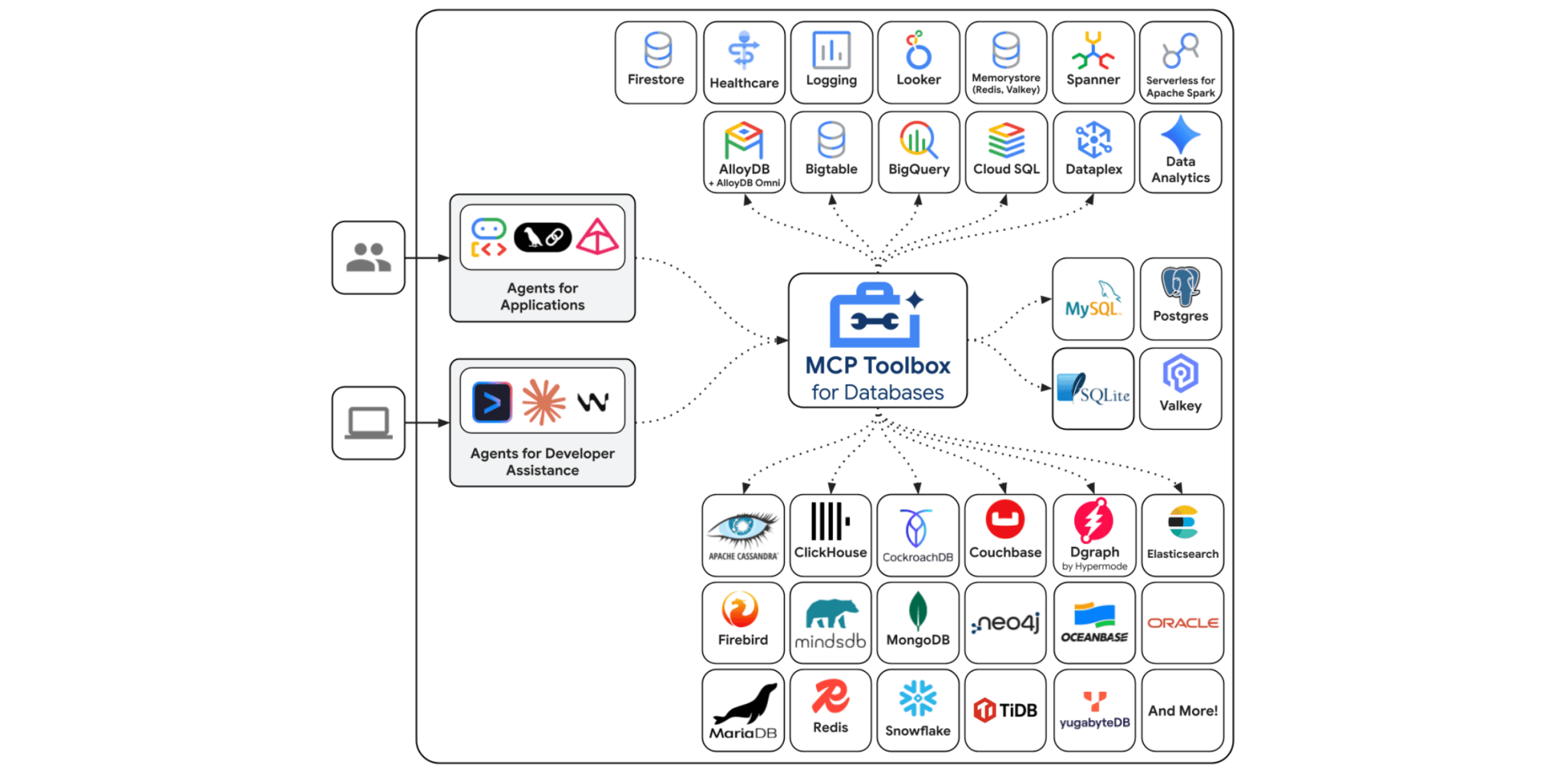

Google Cloud diagram showing MCP Toolbox between an ADK agent and multiple databases
Google Cloud’s architecture places MCP Toolbox between an agent and its data sources, where configured permissions determine the available access. Image: Google Cloud.
