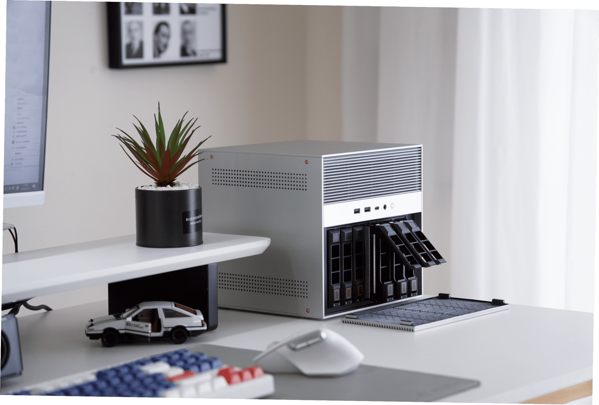

A private cloud or home server setup such as ZimaCube 2 AI NAS can support richer self-hosted media and video AI workflows when storage, GPU or iGPU access, containers, and logs are treated as one system. The important lesson is not the product name; it is the verification pattern. If the UI says enabled but the stream, device, logs, and output disagree, the workload is not fully verified yet.
