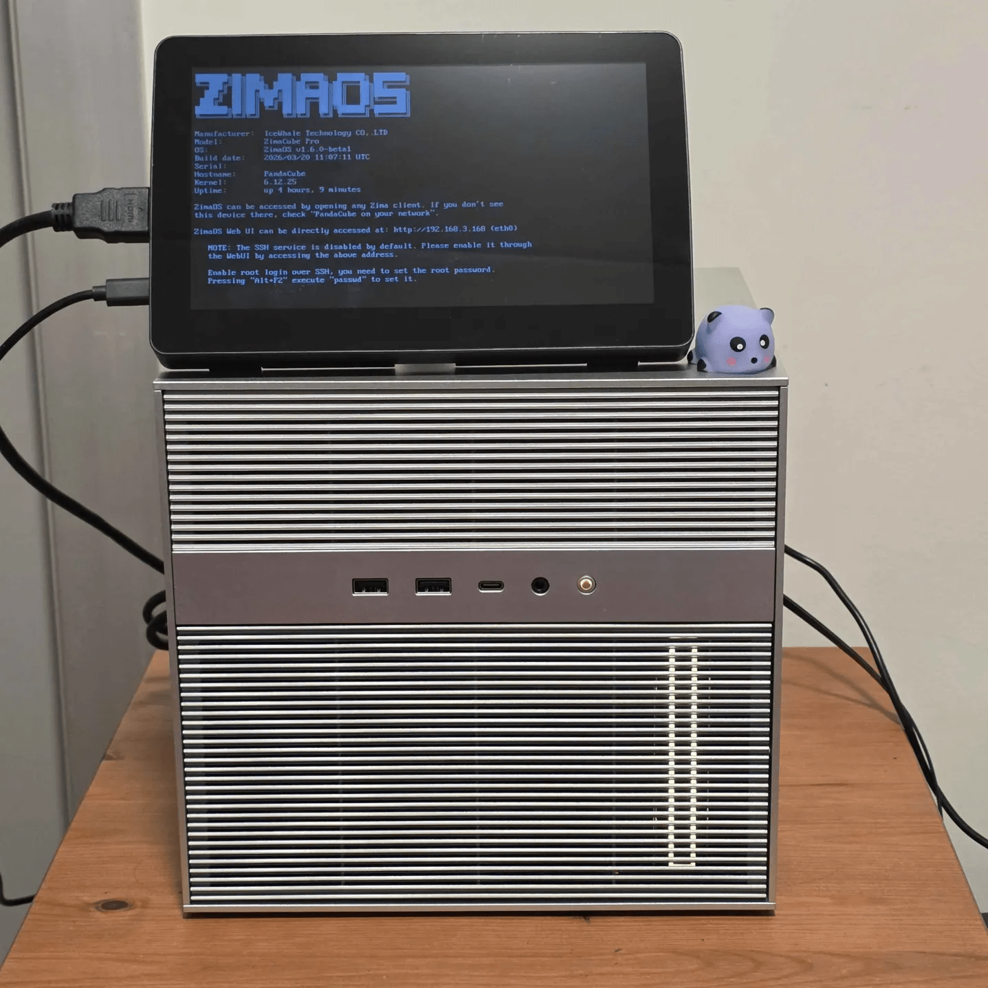

A system such as the ZimaCube 2 Personal Cloud NAS can provide a local foundation for agent services, private files, containers, and persistent memory. The hardware establishes a controllable environment, but the workflow must still restrict outbound connections and protect credentials, databases, and backups.
