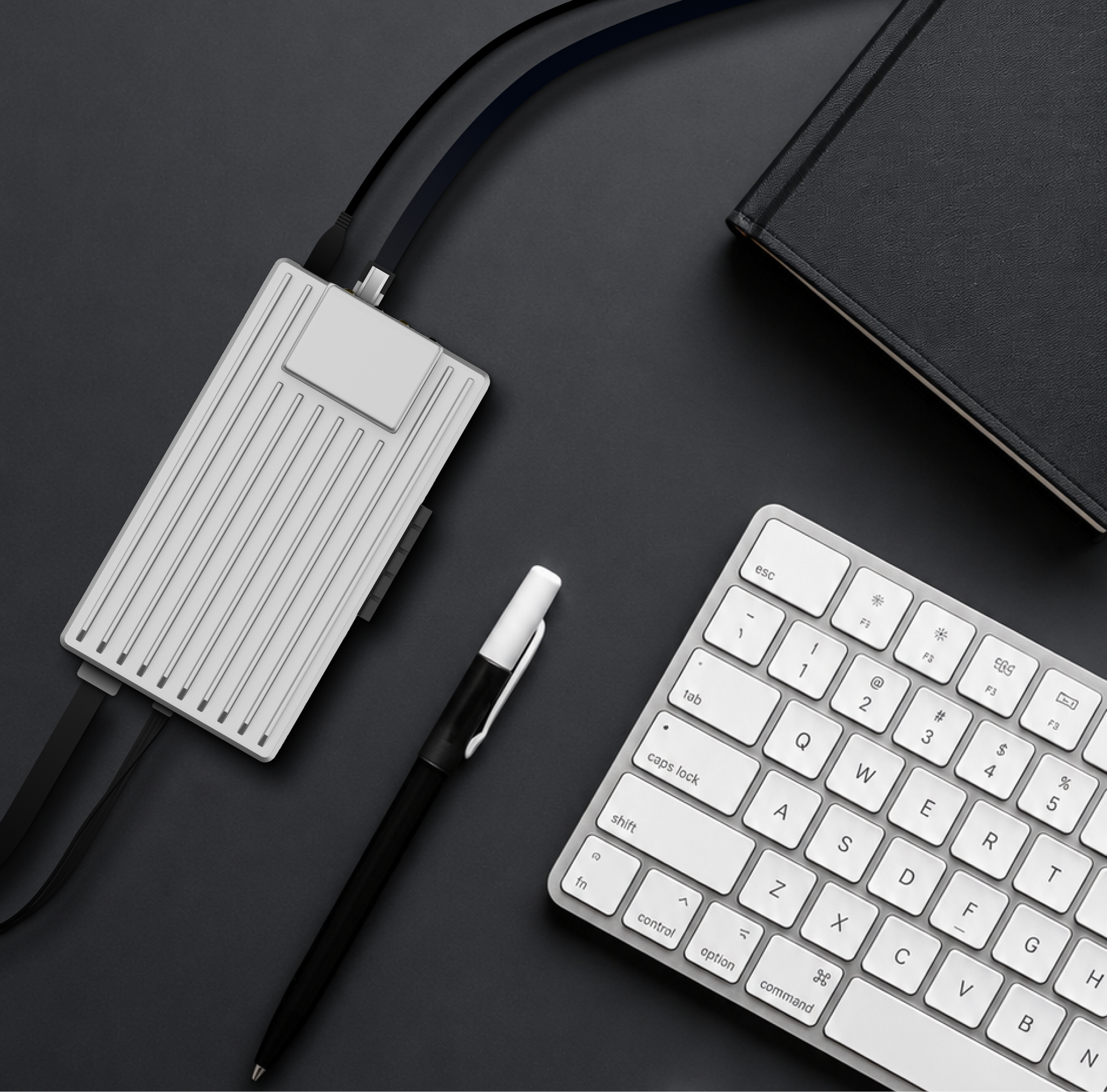

Where a Compact 16GB x86 Server Fits This Decision
For low-cost local AI experiments, the useful product pattern is not a heavy AI workstation. It is a compact 16GB x86 server that can stay online, run Docker-based AI tools, and still act as a broader home server.
That is where ZimaBoard 2 1664 as a compact 16GB x86 server fits the entry layer. Its official product page lists the 1664 configuration as 16GB RAM + 64GB eMMC and positions ZimaBoard 2 around home server use, self-hosting, AI containers, SATA, PCIe expansion, and dual 2.5G Ethernet.
The boundary matters. ZimaBoard 2 1664 is a good fit for small-model experiments, local embeddings, lightweight agents, short-context local AI, and Docker-based learning. It should not be treated as a 32B / 70B model server, image generation box, or heavy multi-user AI workstation.
